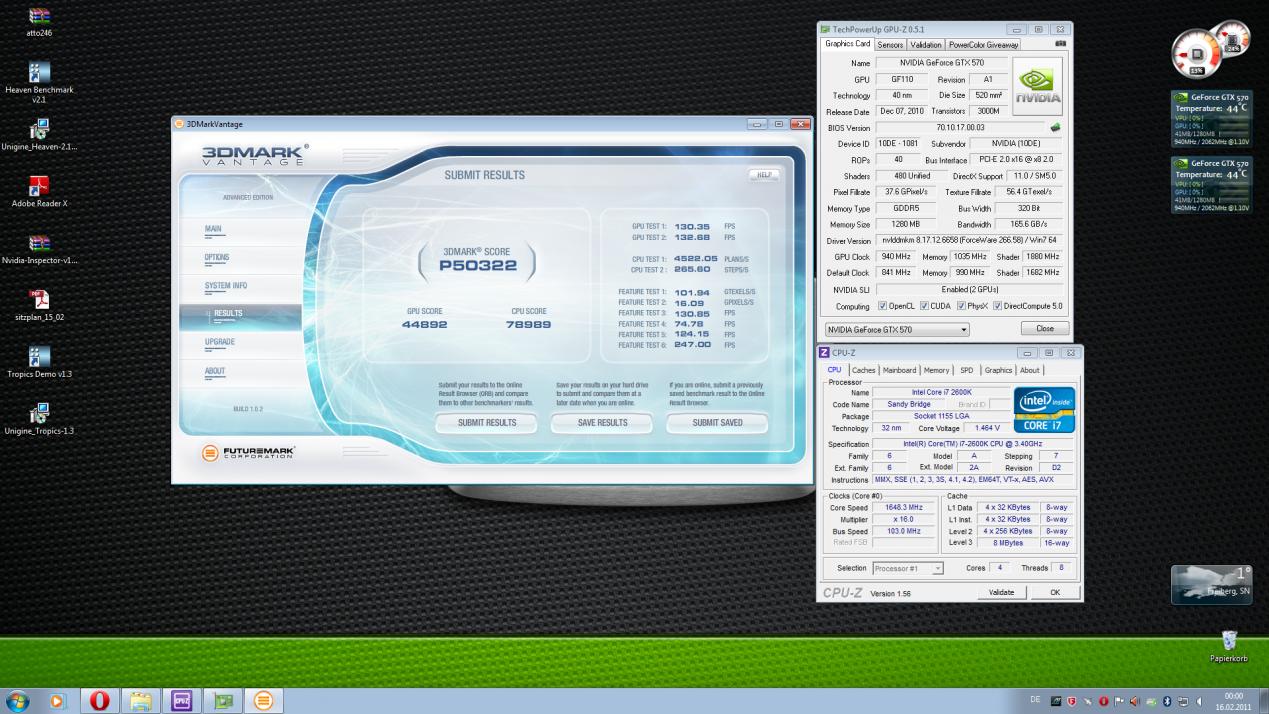

3DMark Vantage:
Atze | Performance | POV | 940MHz chip | 1880MHz Shader | 2070MHz VRam | 1.1 VGPU | i7-2600K | 5,047GHz | 8GB @ 1333MHz RAM | WaKü | Physx on | SLI | 50322

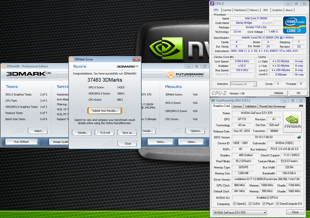

3DMark 06:
Atze | 1280 x 1024 | POV | 880MHz chip | 1760MHz Shader | 2000MHz VRam | 1.1 VGPU | i7-2600K | 5,2GHz | 8GB @ 1333MHz RAM | WaKü | SLI | 37463
