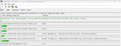

Edit 27.04.2025 <Output LatencyMon>
NOTE: some processes were hit by hard pagefaults. If these were programs producing audio, they are likely to interrupt the audio stream resulting in dropouts, clicks and pops. Check the Processes tab to see which programs were hit.
Process with highest pagefault count: msmpeng.exe
Total number of hard pagefaults 928
Hard pagefault count of hardest hit process: 716
Number of processes hit: 20
Der CPU Relevante Teil
CPU SPEED
_________________________________________________________________________________________________________
Reported CPU speed (WMI): 470 MHz
Reported CPU speed (registry): 4691 MHz
Note: reported execution times may be calculated based on a fixed reported CPU speed. Disable variable speed settings like Intel Speed Step and AMD Cool N Quiet in the BIOS setup for more accurate results.
Muss mal prüfen was ich im BIOS dazu finde. Der Windows Energiesparplan war zwar auf Hochleistung eingestellt.
Die minimale CPU Energie auf 0%
Werde es zum Test mal auf 100% setzen. Aber eigentlich sollte der CPU ja nicht heruntertakten, wenn der Thread genutzt wird.
