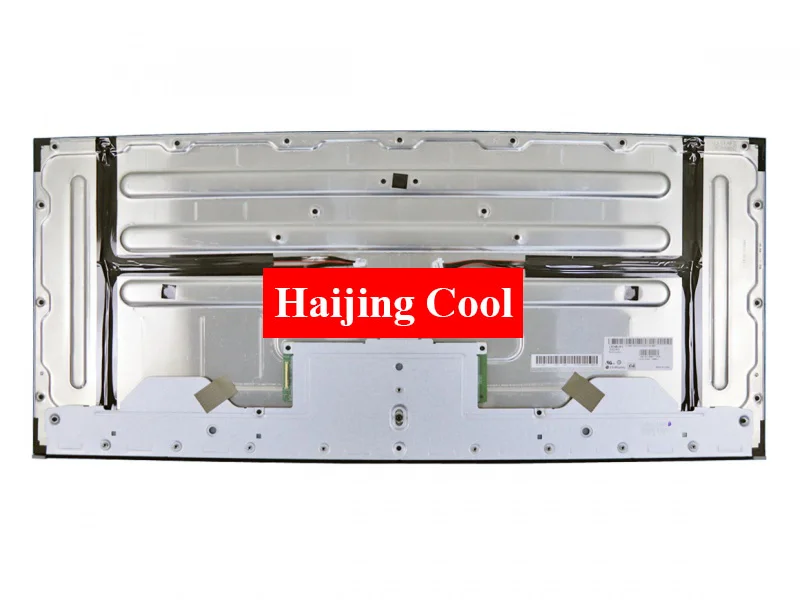

Ansonsten, was haltet ihr davon?
de.aliexpress.com
![de.aliexpress.com](https://ae01.alicdn.com/kf/S46bee8fba7ce4a98a636cdd044d34d1cx/34-Zoll-4k-antike-gebogene-altrawide-Panel-LM340UW5-SSA1-lm340uw5-lm340uw5-ss-a1-ssa1-f-r.png)
228.36€ |34 Zoll 4k antike gebogene altrawide Panel LM340UW5 SSA1 lm340uw5 lm340uw5 ss a1 ssa1 für lg 34 gk950g 34 gk950f Monitor|Laptop-LCD-Bildschirm| - AliExpress
