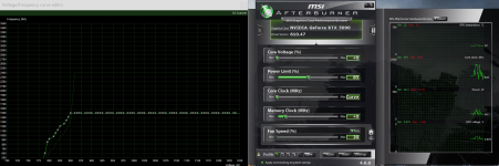

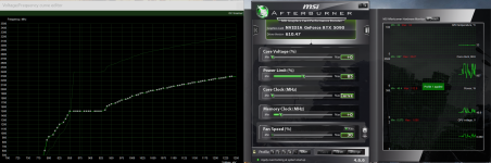

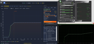

Custom profiles made with V-Lock/Direct don't seem to work, atleast under 900 mV. Once I press apply in afterburner the curve goes different and voltage goes over 1V under load.
Hey @Zango
I checked this now and can confirm , it's driver behavior, not an NV-UV bug.
When you set a custom profile at low voltage (850 mV) with a 100 MHz offset, the driver folds the VF curve back to the stock shape below the lock line and then makes a vertical jump up to the next frequency plateau above it. You can reproduce the exact same curve shape in Afterburner directly: open the AB Curve Editor, set the same point at 850 mV +100 MHz and apply, you'll see the identical jump. Same in Green Curve. All three tools issue the same NVAPI VF set calls, the driver decides the curve shape beyond the lock point.
There is also a small display discrepancy you might notice between NV-UV and what AB or the OC Scanner curve viewer shows. NV-UV displays what was requested, AB reads back what the driver actually applied, and those two don't always match because the driver may snap your point to its own internal grid. That's why the AB curve can look "off" compared to NV-UV's visualization.
One more thing worth trying with V-Lock: if your stock curve cache is a bit stale or off, V-Lock calculations can drift. Try the Recalibrate button in NV-UV once with no profile applied (just stock) to refresh the baseline. That sometimes cleans up unexpected curve shapes.
If what you actually want is direct curve writes without any tool layering on top, I'd genuinely recommend giving Green-Curve a try. It writes directly to the driver with no intermediate layer, which might be a better fit if you prefer to see exactly what you set without the V-Lock abstraction. Different philosophy than NV-UV but well-made and active.

This is my first time doing undervolting, so is there a way to get the voltage under 900 mV working with NV-UV?

My mistake in phrasing, I have been using NV-UV for atleast over a month, in that context it is my first time.
I think the under 900 mV was working before, maybe a Nvidia driver update has changed the behavior.
You didn't answer my question, since any clocks under 900mV seemed to do this curve bounce. Ive tried to have it with even stock MHz. But that seems to have been the problem. It works at 850 mV with over 900 MHz over stock. But at 825 mV for example no number works, low or high.

Hey @Zango,
the answer is in the NV-UV UI itself: below 850 mV you need to switch from V-Lock to Direct mode (toggle right next to the V-Lock button). There's even a hint text in the UI that says "For values below 850 mV → use Direct mode".
V-Lock works within your stock VF curve range, so it has a lower bound at wherever your stock curve starts (850 mV in your case with the current driver). Direct mode bypasses that and writes the curve directly via NVAPI, so you can go below 850 mV.
Try it: switch to Direct mode, set 825 mV with your desired clock, apply.
That should work where V-Lock didn't.
do you re-calibrate just in case?

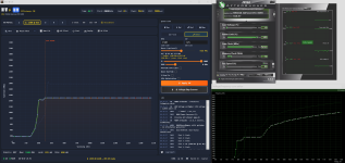

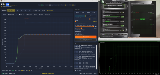

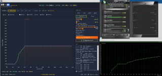

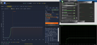

I have re-calibrated, and I use direct mode, still happens.
Using V-lock for 850 mV, you can see with higher clocks the problem gets better, with at +997 MHz only a difference at the middle(?) of the curve.

Hey @Zango
Final update ,I went deep on this and tested on my own card. Confirmed result: 850 mV simply doesn't work correct on the 5090. Not in NV-UV, not in MSI Afterburner directly, not in Green Curve
This isn't a tool limitation, it's a hardware/driver floor on the 5090. The practical undervolt minimum on this card is around 875 mV, and even there you need to target at least 1867 MHz for the lock to actually engage. Below that target the driver ignores the lock and falls back to stock GPU Boost behavior.
If you want a working undervolt on the 5090, start at 875 mV with a target around 1900 MHz. From there you can experiment upward (875/2000, 900/2700 etc.). Going below 875 mV is wasted effort, the card won't honor it regardless of which tool you use.
This matches what the wider 5090 community reports too.
My own observations on why undervolting is limited on this card (just a theory): testing showed the lock only engages when your target frequency is above the stock VF point at that voltage. At 875 mV stock sits at ~1857 MHz on my card, so 1867 MHz works but 1850 MHz doesn't. The driver seems to ignore lock attempts at or below the stock value for the chosen voltage.
That explains why higher voltages give you a wide working range (lots of room above stock to lock to) and lower voltages give you very little. But it doesn't fully explain why 850 mV refuses to work at all even with targets above its stock point. There seems to be a second mechanism kicking in at very low voltage that we couldn't pin down through testing alone. Maybe the driver has additional stability, maybe The Crossbar Penalty, or signal-integrity checks below a certain voltage threshold and just refuses to apply the lock outright.
One more thing worth knowing: in the lower voltage ranges, NV-UV's curve display can differ from what Afterburner ends up showing and what the driver actually applies. NV-UV shows the curve it requested, AB shows what the driver renders, and at low voltage these two views don't always match. I'm putting this on my TODO list to improve, the goal is for NV-UV's display to align more closely with what Afterburner actually shows after the curve is applied.
So your Eco profile in NV-UV (900 mV / 2700 MHz) is actually a solid baseline.
If you want to go more aggressive, try 875 mV / 1900 MHz as a starting point.
