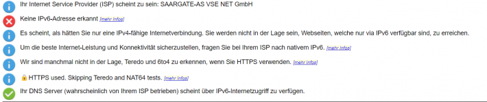

Innogy
Asus DSL-AX82U
traceroute to www.pcgameshardware.de (104.22.11.111), 30 hops max, 60 byte packets
1 192.168.203.24 (192.168.203.24) 28.846 ms 28.615 ms 29.144 ms
2 192.168.126.4 (192.168.126.4) 29.236 ms 29.428 ms 29.401 ms
3 192.168.126.2 (192.168.126.2) 29.094 ms 29.539 ms 29.473 ms
4 022-199-018-212.ip-addr.vsenet.de (212.18.199.22) 29.672 ms 30.344 ms 30.049 ms
5 et-2-0-5.0.vs-core-r1.6838.ip.vsenet.de (217.24.235.181) 30.773 ms 30.692 ms 30.660 ms
6 et-2-1-2.0.vs-core-r1.6898.ip-addr.vsenet.de (217.24.235.153) 31.600 ms 30.166 ms 30.092 ms
7 et-2-0-2.0.vs-core-r2.6898.ip.vsenet.de (217.24.235.162) 29.594 ms 33.258 ms 29.709 ms
8 de-cix-frankfurt.as13335.net (80.81.194.180) 38.440 ms 38.354 ms 38.327 ms
9 104.22.11.111 (104.22.11.111) 34.264 ms 37.710 ms *
VSE NET GmbH wird auch als ISP angezeigt
